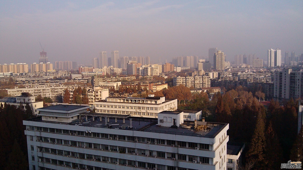

发表于 2013-12-11 20:14:46 | 显示全部楼层
20131211  by:chainawd
